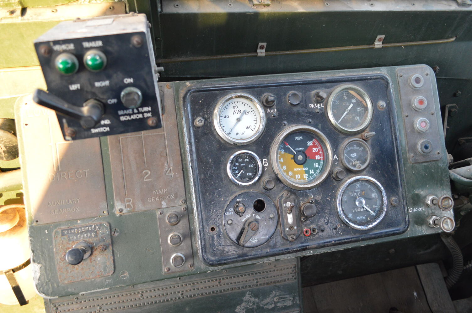

Passed my test using this box in the Scammel Crusader

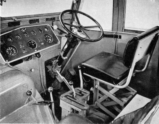

Then earned my wings in this beast. Thorneycroft Antar.

Was thinking of showing that picture to those that complain about modern trucks.
I assume you need to be an octopus to drive it with all those levers. ![]()
But the engineering on that seat is a work of art. ![]()

Reminds me of a jcb for some reason ![]()
Hard grafters back in the day …

The dash too was a work of cutting edge technology ![]()
In the eighties the company I was with had both Sed-Atkis and ERFs. Same type of boxes, Fuller range change, four over four plus crawler. But, due to the ERF having a direct linkage, and the S-A having no hole in the floor and a linkage goung around the cab front pivot, the patterns were mirror images. Changing trucks needed concentration.
And selecting gear in the S-A meant throwing the stick across the cab once there was any wear in the links.
