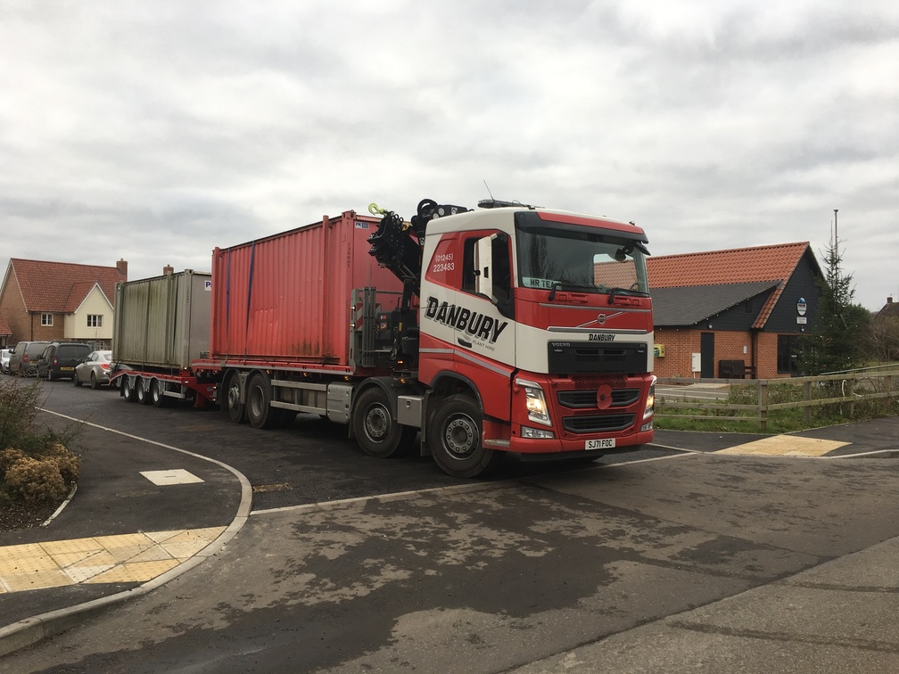

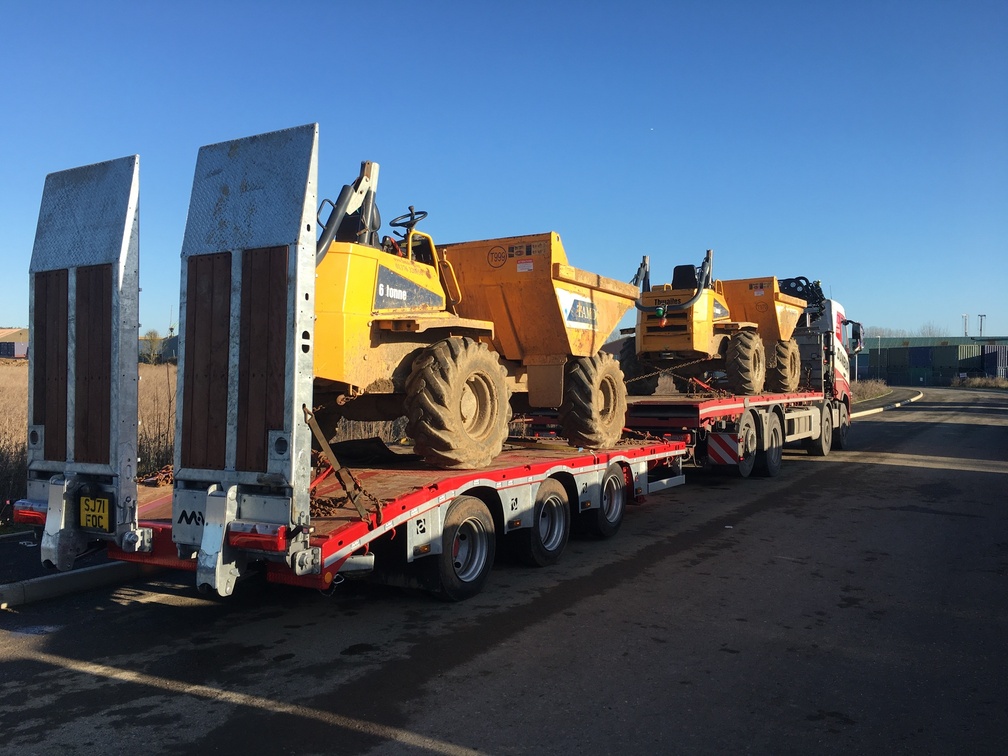

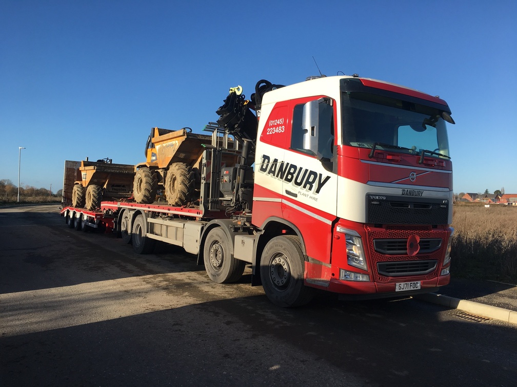

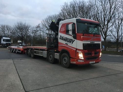

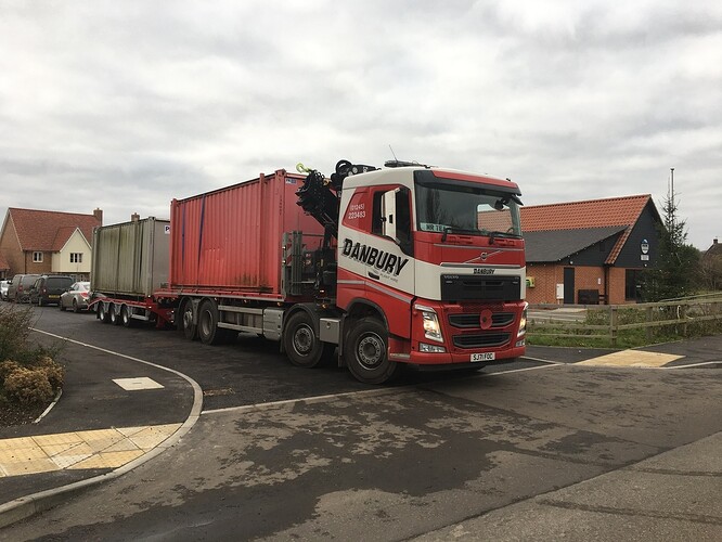

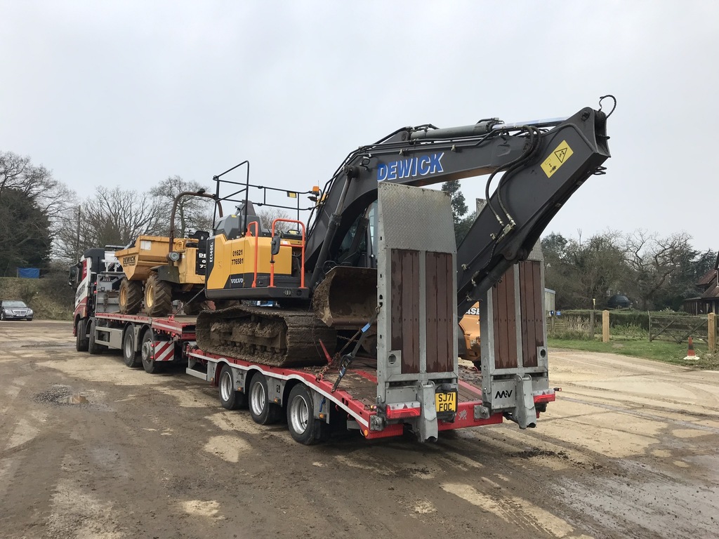

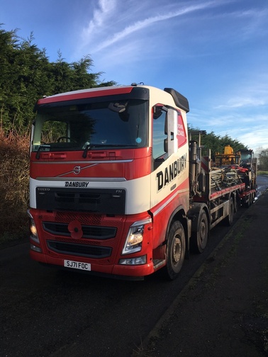

A bit of a thread resurrection but at the risk of waking Carryfast and the a frame monster, I thought I would update on the original post.
Many thanks to everyone who had input in answer to my questions, I was fairly confident I was on to a good concept but wanted some reassurances that this wasn’t going to be a big mistake.
Vehicle was ordered last year and finally was completed and on the road in late December. First ever day driving a wag and drag was straight out from base up to Darsham Suffolk for 2x 21’ containers to Oxford, and unload at 1700 in pitch dark.
So far it has proved to be a useful tool, having the flexibility to supplement our stepframe Lowloader has proved invaluable and on more than one occasion has saved the day when otherwise a job would have been cancelled or postponed. Whilst not out every day (drag) or even all day it’s probably out for about 30-40% of the time the truck is working.
It’s been a learning curve but it has surprised me how easy it is to use and operate. To date only one job has required me to split the combination and load separately. I’ve managed to access sites that I would struggle with the lowloader.
I’ve found that the quality of the road makes a big difference to the way it drives but in answer to original question the drag does not wag the drag when loaded heavy with no weight carried on the truck.
Sorry about the sideways pictures but I’m a technotwat and can’t manage to sort that out.

8wheels:

8wheels:
Punchy Dan:
01Very nice outfit that ,I’am about 18/20 months behind you although I’ve got the crane ,and paid the deposit on an 8 wheeler fh540 low roof :open_mouth:
It’ll be nice then, I quite like the low roof cabs. Still lots of space inside but not bashing every low branch down the country roads. I’d have quite liked a 540 but availability was key for us and the 460 manages our relatively flat bit of the country well enough.
Overall I’m pleased with the setup, the truck body is not as good for doing plant work as my previous vehicles I find that the hydraulic beavertail is a bit steep. However it is quite powerful and if a machine is struggling to climb up then you can lift the tail with the machine on.
Although it has been bought primarily for own account work moving our own plant it has been specced to be as flexible as possible so we can attract more third party haulage jobs.
I’ve ordered front air suspension with maximum stiffness roll bars set up ,what size is your crane ?
It’s a 36t/m with 12.8m reach on front springs. It’s a bit finicky and doesn’t like lifting round towards the cab, it needs a lot of adjustment on the legs to keep it level.
I had a similar truck on hire with a Hiab 418 on it, which was a much better unit.
Full rotation with rear leg beam and never gave me any dramas lifting anything anywhere.
The 36tm is good and lifts well enough but it can be tricky getting things in tight corners.
But other than that I’ve done quite well.

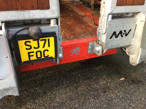

I sometimes get asked if I am Welsh.
No
Why is there a dragon on your trailer?
It’s just I’ve got my drag-on
It amuses me. Plus a nod to my son who has moved to Wales
No
