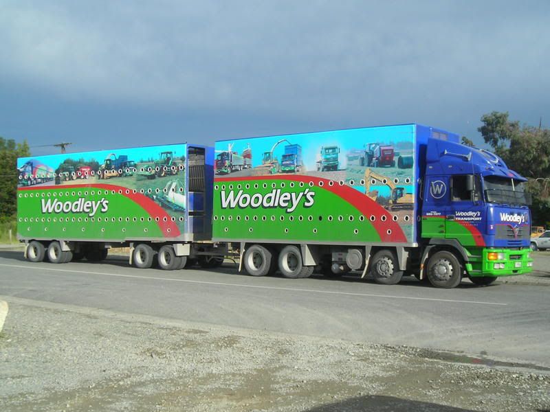

Wagon and drags very common here in New Zealand. They are great for livestock cartage. Reversing is easy once you get the hang of it. The truck pictured has an a frame which has to disconnected and the simply reversed over and you then load stock through your trailer into the truck. The majority of livestock units have sliding drawbars whereby a flick of the switch and the drawbar slides underneath the trailer as you ■■■■ up to your trailer.
Here I am a few years ago south of Taihape with a load of black and whites on. The V8 Mitsi was gutless. Very nimble around tight yards though.
