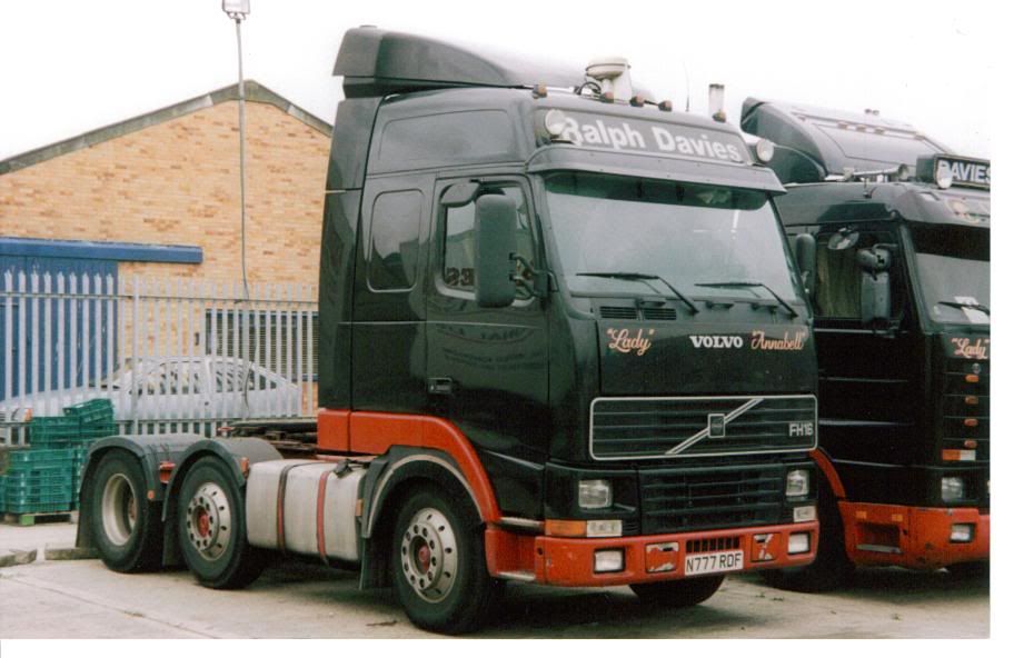

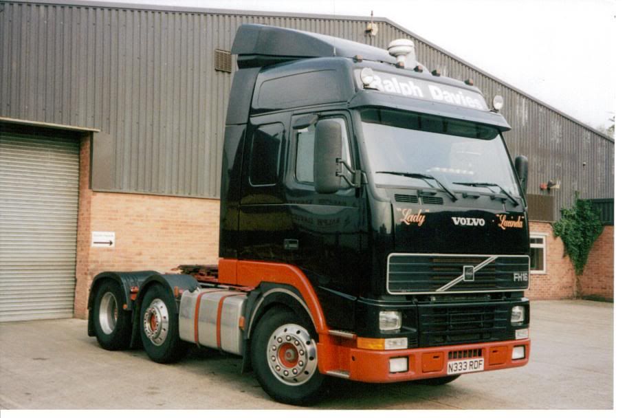

Hi John,
Thank you very much for calling Fin, unfortunately, my tank is not round.
I currently have the one on N777RDF below, but this is slightly too long, too allow the correct new wings to be fitted.
The correct one is shown on N333RDF below, which is part number 8156638.
I believe the original one was injured in Minsk, with a trailer incident. It appears that the current one is off a F12.
Any ideas would be appreciated.
Thanks again,
Ryan

Ryan, if the tank you’ve got is aprox 55" long it’s probably an F10/F12 550l item, it could also be a left hand tank from a twin tank 4x2 FH which is a similar size & would also have the filler at the front when fitted on the RH side. (as would an F series tank)
Good luck in your search.
Ross.
Mk traction break FH’s
Thanks John, I have the part number, but not the measurements as these are not shown on the Volvo parts system.
Spot on Ross, it is appx 55 inches. The one it originally came with was 510 litres, hence the current one is slightly longer.
