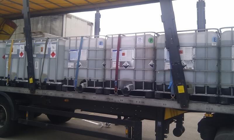

The uprights on the Krone Euroliners I worked on last year were easily as stable as the uprights on the UK style Curtainsiders I work with now. At least it was a fair attempt at an explanation for the ‘tilt boards’.
My own theory is that the Euroliners are so flimsy that they need the boards to make the thing more stable but I have yet to see any ‘Coffeeholic’ style proof that fitting them is a legal requirement or that my theory is right. I would of thought that might be useful information for JD as well as satisfying my curiosity.
W
I think as you used an IBC load as an example, I have used this photo that Dinosteveus posted to show why tilt boards are still necessary on modern sliding roof trailers, they hold the support posts perpendicular to the bed which in turn hold up the roof. Straps over the IBC frames secures the cargo.
Thanks Wheel Nut
‘A picture saves a thousand words’
