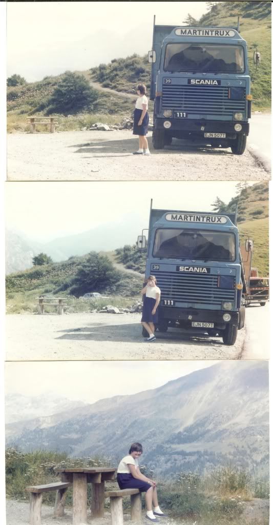

hard to see but thats 2 tilts going up cenis to be buit up near Turin , so hot hey ■■■■■ cat get a hard hard , you will need it when it falls apart

Yes i thought so and i have rebuilt a tilt from the deck and i HOPE you never need to but yes old times will show you how. the 2 tilts i took to Turin was just a small shipment with tilts and 142s inside stepframes and i have seen 1 driver taken to hospital when the cantrail fell on him, i have done this in July just oustside Turin. yes was no hse or anything
