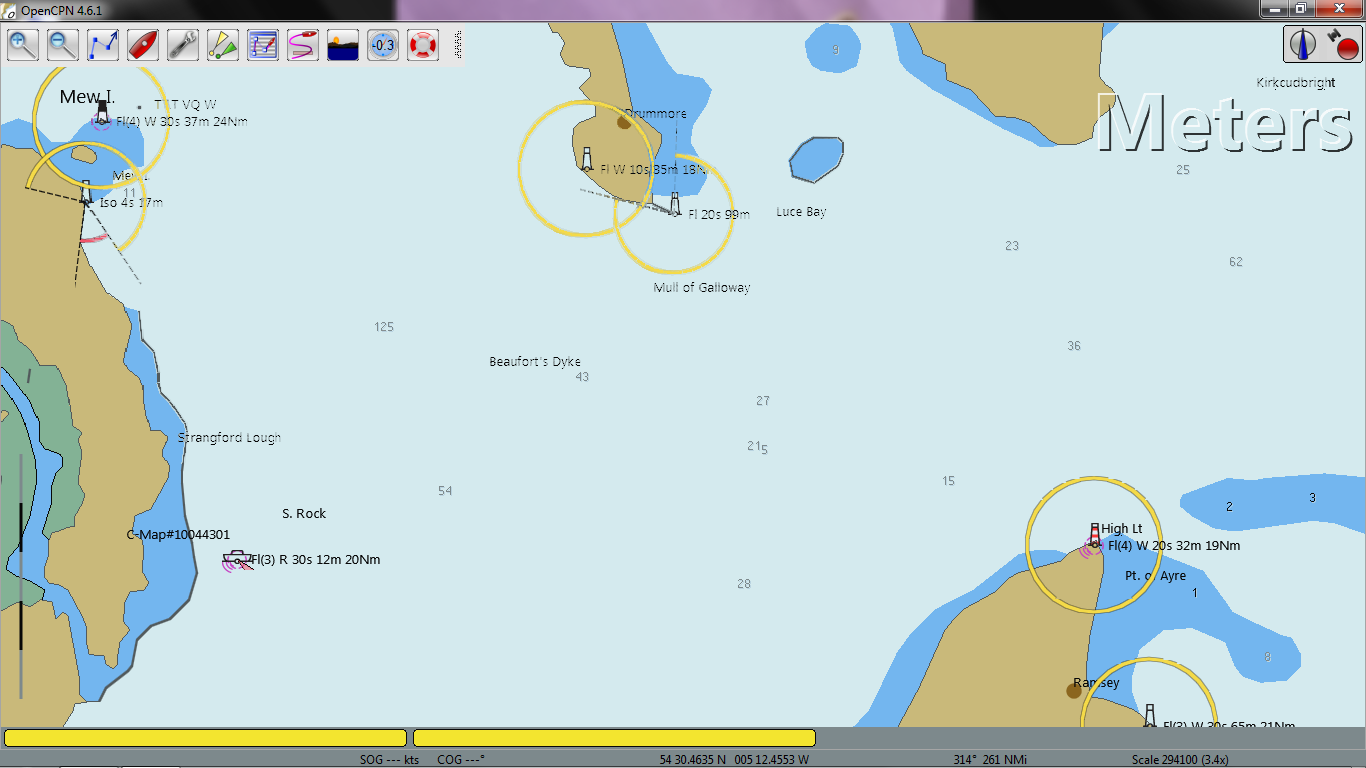

This is a screen shot of a raster scan of the offical Admiralty chart, the depths are as indicated …

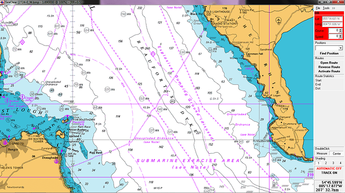

More detail in this one …
