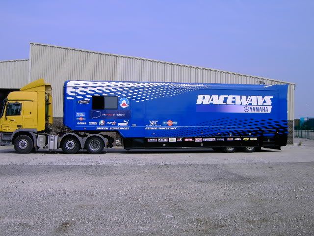

Sometimes they just have to sit a long way back so the chassis doesn’t foul the trailer. You should have seen the dints & damage to front lower panel on this trailer!
Enjoyed this nice easy run from Fleetwood to Castle Donington with a rather unusual trailer for POFM to be pulling. :wink:

In theory you should allow a gap of approx 550mm between the cab and the front of the trailer. you will normally have different kingpin positions varying from 1200mm to 1600mm. A fixed 5th wheel normally set for the 1600mm position so if you hang a 1200mm kingpinned trailer on you would be over length and probably overweight on your drive axle.
I would always use my fore arm as a guide but don’t just check the back of cab measurement also use it to measure rear lights to legs clearence. Our boss always had air operated sliders fitted so we always used them.
The example picture shown with the Merc pulling the racing trailer really shows how not to do it.

It was a bit further back than it need be but this why:
I was on my own, no one around to help as it was lunch time. Been on a steel strapping course that morning & everyone else had got away whilst I was on break eating my lunch.
Initially couldn’t get hold of the pin before the chassis was going to foul the trailer.
Had to go back to another yard to use a trailer as an anchor to move the 5th wheel that hadn’t been moved in years.
The release handle would not stay pulled out.
Waited until another driver (not one of our own) showed up & got him to hold the handle out whilst i moved the truck - watching his toes!
Went back to the race trailer & once coupled up was in position as seen.
If the handle would have stayed out, I would have closed the gap a bit, but I had no way to do that alone.
Weight was not an issue.
