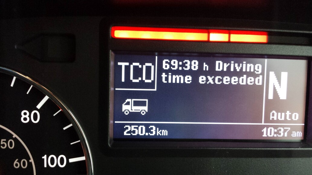

Serious Tacho infringement

It was a siemens (vdo) and I have just watched the video on youtube. I must have told it I had been working all night when I did the manual entries as I have not used a siemens for a while so it caught me out. Oh well if you can’t do the time then don’t do the crime so I will just have to hope for parole?

Dont worry ive had the same…last day at work before 4 rest days.returnef to work,put card in tacho and this is the msg i got…the tacho unit fault was it never showed me having finished work 4 days ago.

I have put my hands up and admitted that I cocked up the manual settings. I had to do a manual entry as I had been in the yard 40 minutes before getting this unit. I also had to change the previous day finish time. This process is easy to do but the problem stems from not enough info on the screen and three types of tacho in use that run the menu differently. Anyway I will do my best not to let it happen again :wink: There is no need for Trucknet CSI to be on the case here as the culprit has admitted his short comings :laughing: :laughing:
When you put your tacho in and recorded shift ending at 17.45 you should have logged from that time to start time as rest. If you don’t the card doesn’t know and assumes you were on duty.

Unfortunately this is often the cause of the problem in the first place. In the newer version of the Siemens VDO, which I think started appearing in 62 plates or around that time, if you skip the manual entry it adds the time from card ejection to card insertion onto the card and will assume you never clocked off. This is how people insert their card and it tells them they’ve already drove for 4 hours. Whatever driving time you were on the shift before it will say the same after you reinsert the card.
