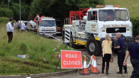

With that tragic landslip in Dorset I noticed the recovery operator was running an ex-mod Foden wrecker:
Do you know anything about them because I was always under the impression they’re no use under civilian regs because the train weight is not up to anything, maybe due to single tyres only on the rear axle?

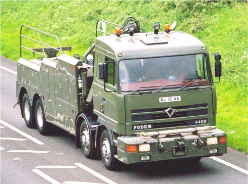

The only proper wrecker the army have I think is the Foden one that used to travel with the nuclear convoy, haven’t seen it for a while and always thought it would be a good buy if it came up for disposal:
Nowt to do with the train weight (Dave Crouch’s UniPower ‘LionHeart’ is a 4 wheeler with 120ton train weight).
Where Bride Valley are based, I would imagine the landscape means they’ll have use for a solid winching tractor.
Witham SV / L Jackson and Co are knocking these Fodens out for £25k now, a hell of a lot of truck for the money.
Ex army wreckers are fantastic winching tractors, BUT…they’re useless for recovering civvy motors.
This is because they have very short armed underlifts, MoD trucks have lifting eyes right at the front of them (you can see them in this pic, two lugs sticking out the bumper between the headlights), so only a short under reach is needed. There’s not many civvy trucks about that you can lift by the front bumper - you need to lift the axle, wheels or springs, so a good bit more reach needed.
Some of the newer continental coaches need a massive reach (and wheel grids).
That photo above is a good bit of kit for the MoD, but to be fair, in civvy street it’s just a basic lift-n-shift motor, probably not much use for wrecking/roll-over work.
