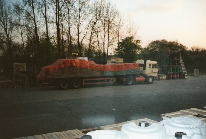

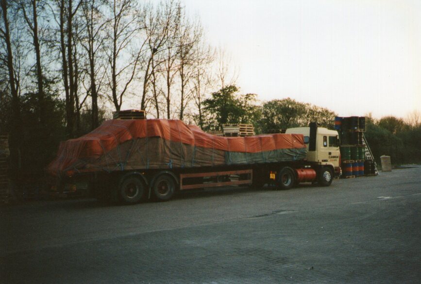

adr:
A couple of my efforts from, struth 20+ years ago! I used to like to stand back & look when I had finished, rope & sheet always looks better than any tautliner. Some could do it better than me but I didnt mind it & I never had anything fall off so must have been doing something right.
hi chris,are you sure you did those?as i recall most of the pfa loads out of the yard were all done for ya by the good looking young yard boy of the time!!can’t remember his name,what was it??actually looking at them they must be yours cuz i think he done a better job :laughing: :laughing:
this was loaded out of chirk brand new sheets touched floor both sides & some
not one of my better efforts :frowning:

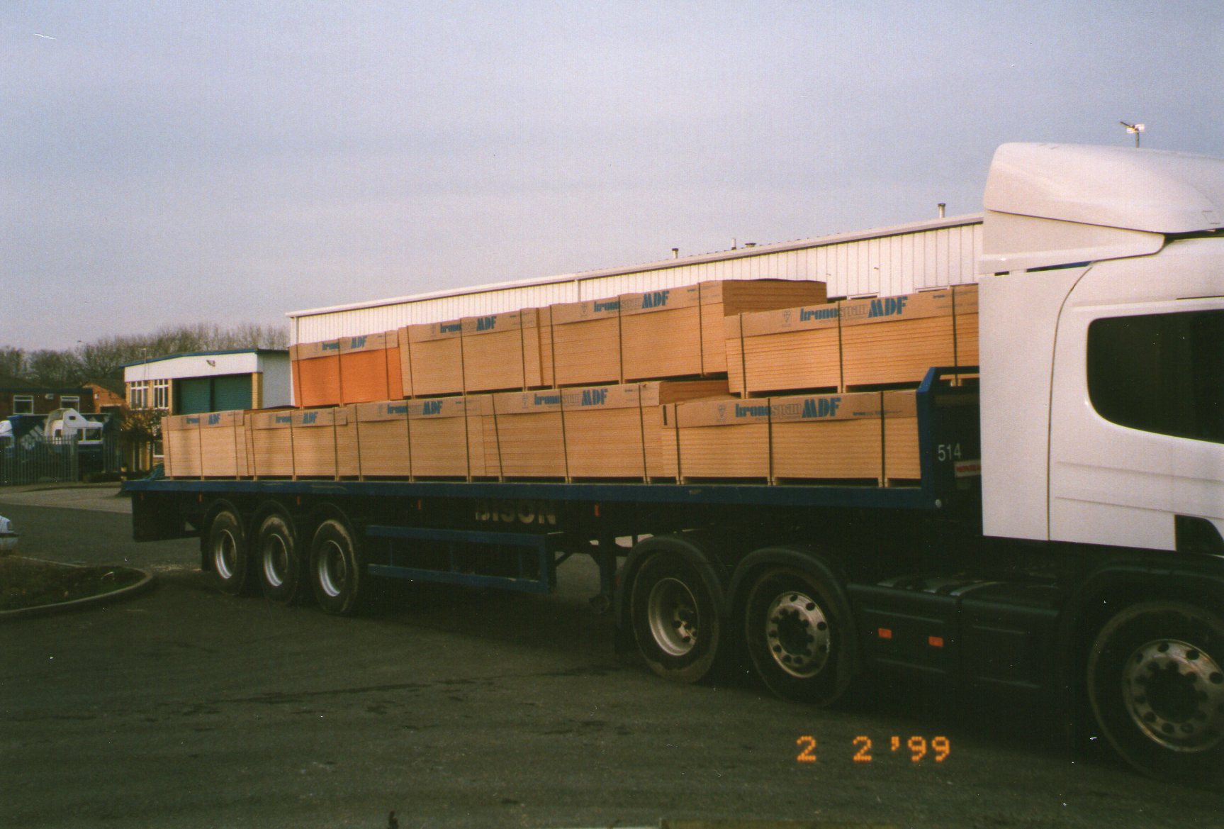

Andrew Morrison:
10

Dennis get the cotton wool ready for the office girl’s ears he’s roped over the flysheet tut tut.
thanks harry long retired.
Quite right “H” they should be “had up” for cruelty to fly sheets!!! Cheers Dennis.PS they look nice and tidy but roping over the fly defeats the reason for fly-sheeting in the first place!!!
hi all,now ere we go!! in my defence!! i do know how to rope & sheet properly had some good teacher’s(take a bow boris & duffy) as most things in life there would of been a reason for doing it that way sorry i not got any pics of the proper ones also this sight is about ‘roping & sheeting’ not ‘perfect roping & sheeting’ i can take constructive criticism not criticising for the sake of it.it wasn’t you that used to watch me trying to fold my sheets in gale force wind & driving rain was it??if you listen you can just about hear me climbing down off my high horse sorry just a bit touchy about some things!! especially in this day of people that can talk a good job,wouldn’t let half of em loose with wheelbarrow, well thats my winge out the way sorry to you all regards Andrew :laughing: :laughing:
