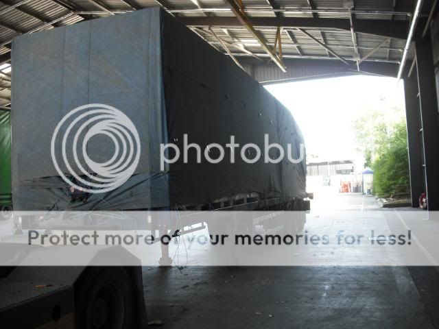

Pehaps these pictures may help explain how to do the corners.
Our product doesn’t need to be kept totally dry.And not having loads of sheet to tuck up makes doing it 10 times easier.
Tonyb
helps as well if you have decent sheets to use, coils of tin plate today , was well warmed after doing this
5 hours later all still nice and tight
Very nice. It’s good to see some decent work for a change. If it wasn’t for the registration number, I would have thought this photo was taken years ago.
Nice job.
Looks like Kingspan tonyb must be about 7/8 yrs since I was in there
i suppose after 20years of general haulage i,ve just about got the hang of it george :wink: mind it never gets any easier, even when you do it every day !

Heres my humble efforts a little while ago!
Hope it’s upto standard! :smiley: :sunglasses:
Good job that chavers,looks very neat and proffessional something to stand back and be proud of.
regards dave.
Sneaky.
I’ve just figured it out. That’s a purpose built flysheet type thingy. :laughing:
I’ve been trying to find the join between the front and rear sheet. I then noticed the “flysheet” was stitched onto the main sheet. It’s an all in one flysheet jobby, with a bungee and extended sides about 4’ deep.
Right or wrong?
Still a job done well though. :wink:
its just the same type of sheet i always buy george, its 50 feet long and 12 or 13 feet wide, pvc for the top middle section to keep the water out and cloth sides to make it a bit more workable, i also carry 2 x 20 feet under sheets in case it needs double sheeting as that load did and then 2 x 30 feet x 16 feet wide cloth sheets for carrying timber :smiley:

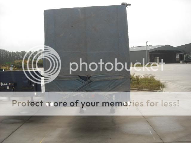

Before and after.
Tonyb
i dont mind them big square loads, no loose sheet to get rid of just pull it straight and square it up and off you go, its just standing on top to roll them out i,m not keen on :laughing:

chaversdad:
If you look in the top of the last photo,there is a yellow beam.i’m harnesd to that.So falling off shouldn’t be a problem.Not that i’d want to.And sheeting under the shed is a whole lot easier than a windy dock somewhere.
Some loads we get are only a few feet high.And loosing all the excess sheet is a real pain.
