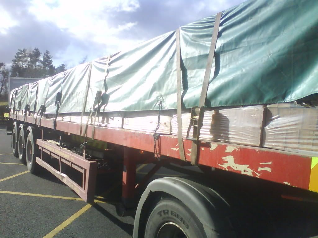

My second attempt no help ok i cheated i used straps
Not to bad Mr Adams for a 2nd attempt but next time after you have rolled the sheet out fasten the 4 corners first keeping the sheet nice & straight then do your tyers along each side. To get round excess rope take your rope to the hook infront of the eye come along to the next hook behind the eye then take the end slip it behind the horizontal & bring it back to the rear hook & tie it off that way you are keeping the sheet nice & taut & using up the excess rope. Hope this Helps :smiley:

Hmmmm, not a bad effort of sheeting ( no rope in sight) but straps shouldn’t go over the sheet, particularly a ‘dripper’ as they will damage it. Always strap under a drip sheet then keep the dripper tight by tying front, then use the back tyers to tighen the whole sheet ( even using a dolly if necessary). A rope cross, front & back and a couple of ‘throw overs’ should be suffiecient! :smiley:
If only it was always that easy lmao :smiley: :sunglasses:
Hope you don’t take this as a critisism, just a helpfull observation. If I was about, I’d gladly give you, or anyone else a hand to r&s :sunglasses:
