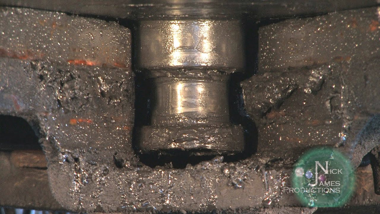

I think a lot of drivers need to watch this video and ask the fitter to show them how it works with a greasy stick.
