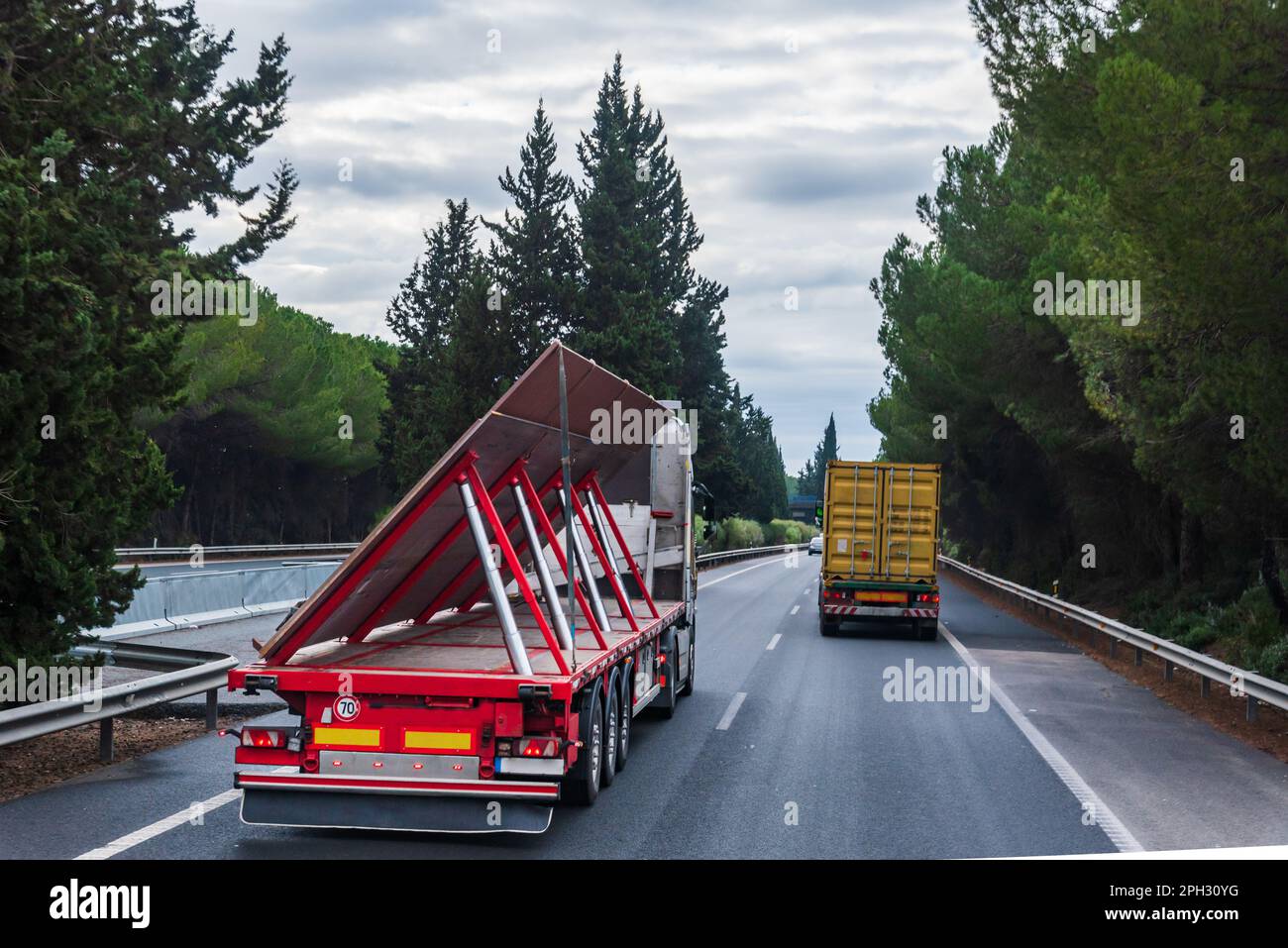

Trailer with body folded up to the headboard. Note rear doors and space for a 40ft box.
Thatâs pretty snazzy, except you lose 5â of loading space and not to mention how it would play havoc with the axle weights.
Arenât modern coilers like that, with a sliding canopy over a well sunk into the centre length?
