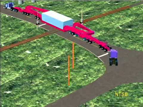

To Patrick @pv83 and all other ‘heavy’ drivers, have you seen this reconstruction and what do you think of it?
For what it is worth my own contribution is in a reply (as ‘D’) to the 3rd comment down, ‘earlmauger’.
Interesting, and to save your grief for the ‘pusher’ driver, both he and his wife were actually on the back of the trailer operating the steering (not sure how the tractor itself was steered) and jumped clear before the impact. Everything else, including the train, or part of it, was written off. Very expensive.
From the accident report:
" no one contacted the railroad in either accident to determine whether it was
safe to cross the tracks."
“the minimum time the vehicle would occupy the crossing was between 57 seconds and 2 minutes 50 seconds. Active railroad grade crossing devices are required to provide a minimum of 20 seconds of warning time to motorists before the arrival of a train, and typically these devices provide between 20 and 25 seconds of warning. The warning devices at this crossing provided a warning time of 25 seconds”
But also this was the second time this occurred here!
“This accident was very similar to the 1993 accident at the same location. Although
the motor carrier was different, the KUA was not only the owner of the crossing and the receiver of both loads, it also had representatives at the crossing during both collisions”
Wow. I got really interested in that and have just finished reading the whole report, though speed reading where I didn’t see it as relevant. Mind blowing. There was a requirement in Florida to notify the rail authorities of the movement, but the carrier, who didn’t know this, had nevertheless tried for a long time to find a contact to do so anyway.
1 of the 3 es cort drivers did not have a permit for Florida, and one of the truck drivers didn’t either.
This came to my notice because of a driver on the American forum pointing us in the direction of the accident. How was I to know that it would prove so fascinating. Thanks for the link @franglais
As a result of this I have looked at a couple of other NTSB YT reconstructions, one of which was a bit close to me involving a ship collison in an American waterway. The pilot(s) in this case were at fault but it reminded me of my own terrifying experience at the wheel of a tanker through Suez. On that occasion my nervousness was unfounded, my pilot was the soul of calm, as was the captain on the bridge with us. Remembering that, if I had been with these 2 clowns I would have become a dribbling wreck. :rofl:
I found it amazing that the company (KUA) having the load delivered had a similar accident previously. Not learning from another’s mistake is not good, but not learning from your own mistake is awful. Maybe the personnel had changed, but not putting a suitable procedure in place is terrible.
It happened twice, literally on their own doorstep.
