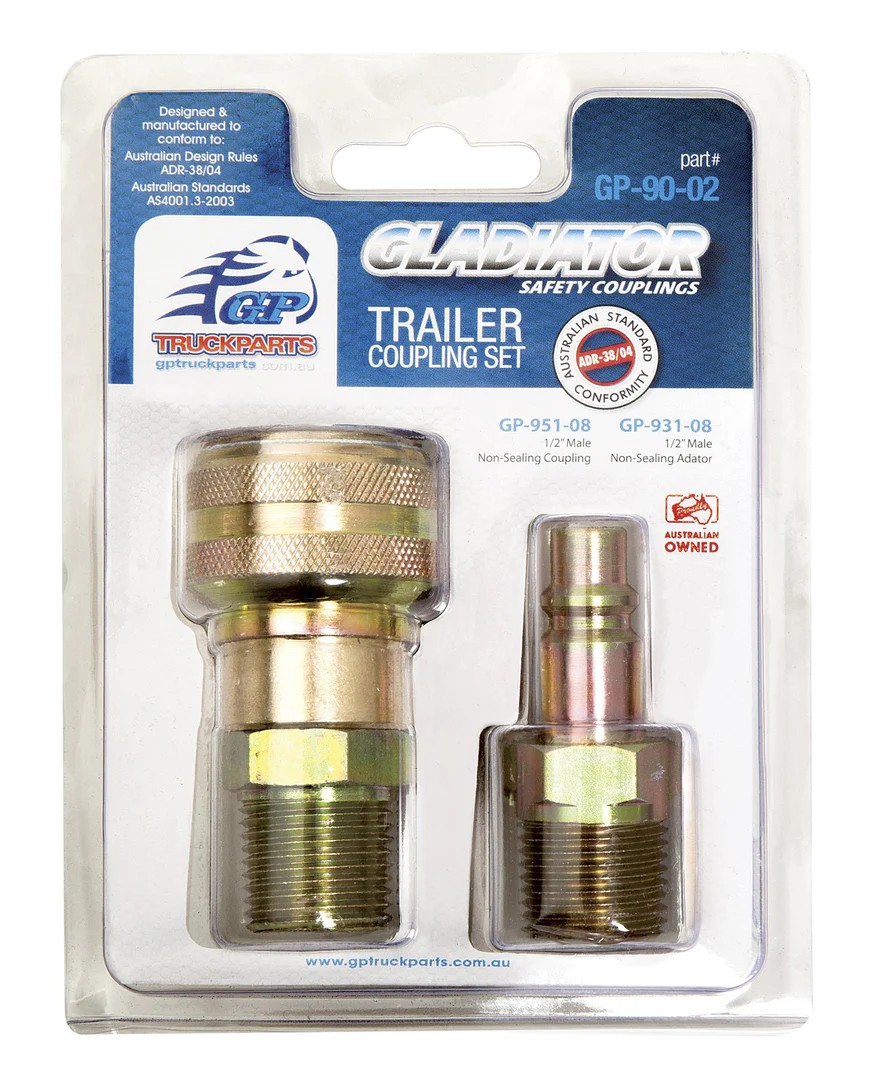

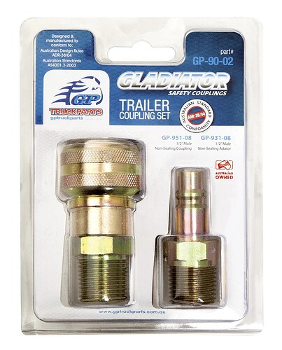

The UK and Ireland are unique in the use of the C coupling. All the rest of Europe, the whole of America, North and South, Australia, New Zealand, the whole of Asia and as far as I know Africa use palm couplings. As far I’m concerned, they are all wrong, horrible, wobbly, leaky things.
Glad hands or palm couplings were old fashioned fifty years ago here, and I expect Un Zud. I’ve never used them.
This is what we use to comply with Australian Design Rules.

I experienced them in the 80s on Norfolk Line and i wasn’t convinced. We were still using todays couplings with taps on our trailers and they felt much more secure

Old “hands” here in the US always had a few rubber inserts for glad hands. Never leave home without them.

Also spit on them to lubricate the rubber seals before coupling them stop them sticking and tearing.I preferred palm couplings to C couplings on our salt covered roads.
Especially for drawbars where couplings were exposed to road spray and difficult to apply leverage to push C coupling valves.Was always washing them and putting engine oil on them to keep them from jamming.
