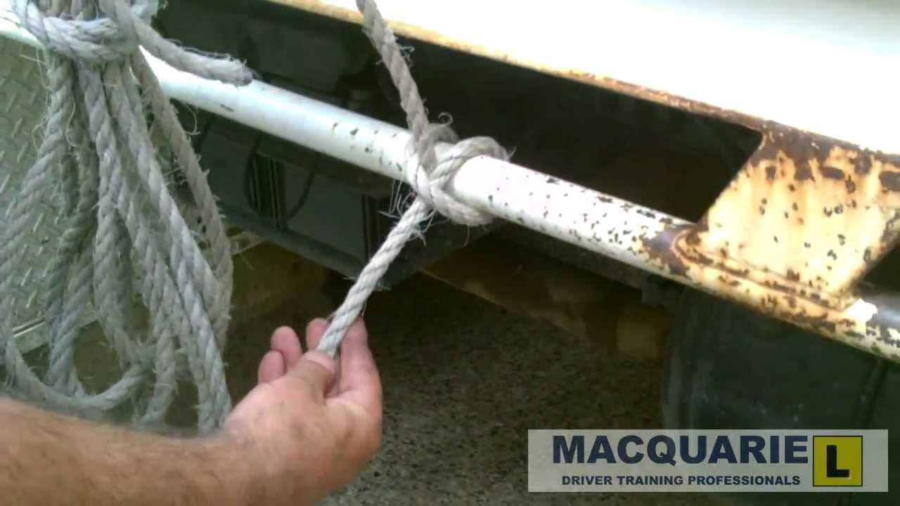

Both the Aussies and Kiwi’s use the dolly knot,but they are tied off on a rope rail which runs the length of the trailer instead of rope hooks.
So how is the rope tied off on the rope rail please?
It’s a right bloody farce,you have to half complete the hitch then thread the loose end through the back of the bar then feed it through the twist before tightening the hitch,what a balls-up,why can’t they just use hooks ? :unamused: Cheers Bewick.
Hope this helps - looks a faff :neutral_face:
http://www.youtube.com/watch?v=73hHtb_if1g
What a load of bollox,bloody great long winded hitch and a short,made to measure rope.The only thing you could say in his favour was that he wrapped his little coil of rope up nice and tidy,but then it was only 15ft long,not 90ft as normal.

I’d like to see that “trainer” from McQarries sheet and rope one of these loads :unamused: Bewick.

Rope rails are a right royal pain in the axxs, you have to carry a load of ropes at about 20 feet long each, rather than a good long length. And you have to break the top dolly to get the loop in as well. Thankfully Australia now has mainly rope ratchets attached to the flat beds so you tie one end of and chuck the other over the load, feed it through the rope ratchet and tighten it up like that. The ratchets slide along the rope rail so there shouldn’t be any kind of weird angles necessary to get it to the next hook. And they tend to use a ticker rope as well about 20mm to 25mm.
There are all sorts of variations (or were, I see very few using ropes any more - come to that flatbeds are dying out, at least around where I work), but it’s more or less how I learned when I started on flat beds here. He does make a dog’s dinner of tying the dolly (hitch) cos it’s much easier to have a half loop over your wrist when putting the dolly in than all that tiresome feeding the loose end round the bar - it cuts the time and messing about in half. Tying off on the rail is a simple clove hitch and you can get just as quick tying one on a rail as doing it by doubling loops on a hook.
Rails do mean shorter rope lengths but that isn’t all bad - they’re easier to handle and stow than 90’ lengths. Rails can be a pain in the fundament but on the rare occasions I’ve done roping in Britain I found it annoying not having a hook in the right place (to keep the rope at right angles to the wagon). So it’s horses for courses - both rails and hooks have their advantages and disadvantages and most of the criticisms of either are simply a function of what you’re used to.
As I said, I’m used to rails so it doesn’t bother me and I’d probably get the $hits coiling up 90’ lengths of wet rope rather than several shorter lengths. But it’s just what you’re used to I guess…

He used most of the rope just to tie the Dolly, what does he do to when he needs to go to the ‘next hook or two’ along as we would or does he just have a cab full of 15ft lengths of rope to go over once!
I agree it looks a bit odd but remember this is a demo to show how the knots are tied - it’s not how it gets done out on the road. You can move along the rail and start over by taking the loose end and going past one or more of the rail supports, then over the rail then back over the load. It’s a bit of mucking about but not much worse than going between two hooks.
