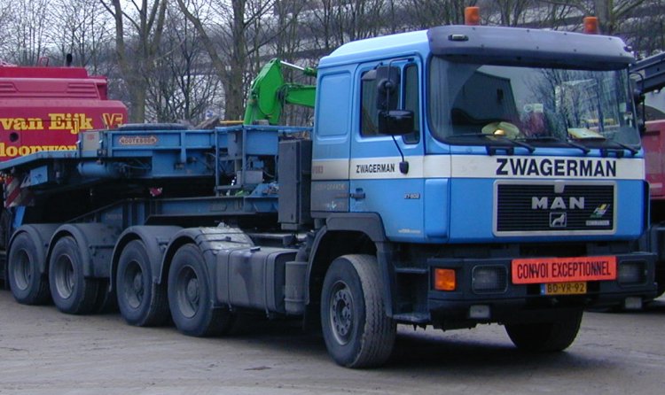

Another feature of this tractor is it’s torque converter. It’s a ZF WSK-400 unit. The cooler of this converter isn’t as big as that of a WSK-440 and is therefore not visible on the pictures. The cooler is mounted somewhere between the chassis. The torqueconverter gives the truck the ability to tow away such heavy loads without damaging the clutch.
MAN with Torque Converter
