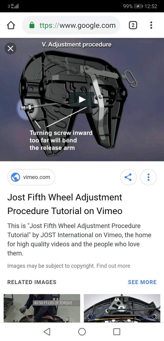

I worked at Wordsworth holding who at the time manufactured Big d fifth wheels , ramps , sliders etc , the jaws were machined on a mazak cnc Miller , those fifth wheels often came back under warranty claims for various defects .
The fifth wheels were fitted up on a jig ( I did it on accasion ) and there were often issues getting them to work correctly , but as you were on piece work you didn’t want to spend a minute more than you had to getting them to work correctly !!!
I’m not saying this is any thing other than driver error , but the fact they would come back under a warranty claim , you’d think there could be a possibility of it being a defective fifth wheel
The same applies to jaws , after they did away with inspectors you then relied on the machinist to get every component within tolerances on engineering drawing , you’d find a inspector would make sure components were within manufacturing tolerances , but again if your on piece work the odd micron/ thou here and there , it will be ok
Nb I’m going back 20 yrs , think Big d was sold to jost so it maybe of no relevance’s in 2019

Big D’s were never really had to be precision engineered, ish would have been fine and we would use the adjuster after fitting to adjust to work correctly, possibly sent back because they were not adjusted after being fitted.
