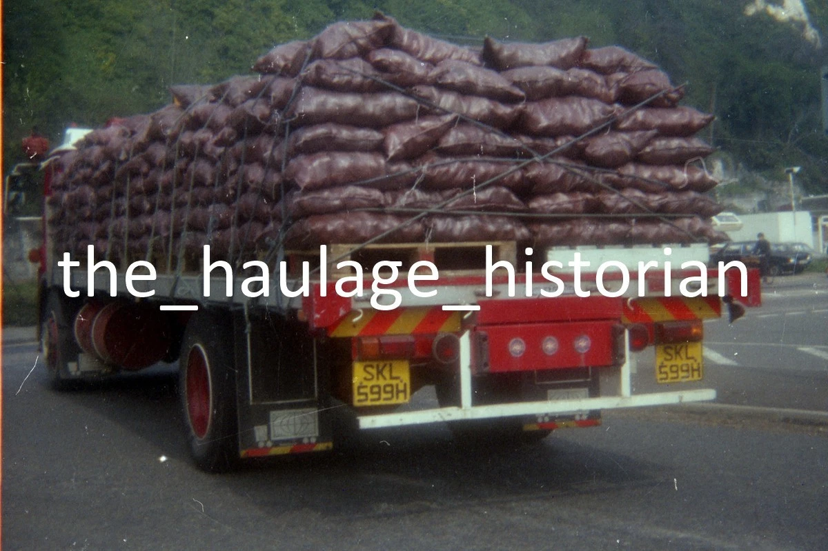

I wonder if sheets and straps will keep this on ?
