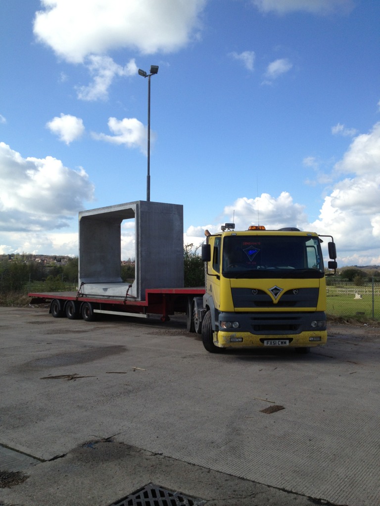

took this up the other day, was getting 4.5mpg, so pls tell me how i can improve the mpg, i only run at 50mph tops too, perhaps i need to move the trl closer…lol

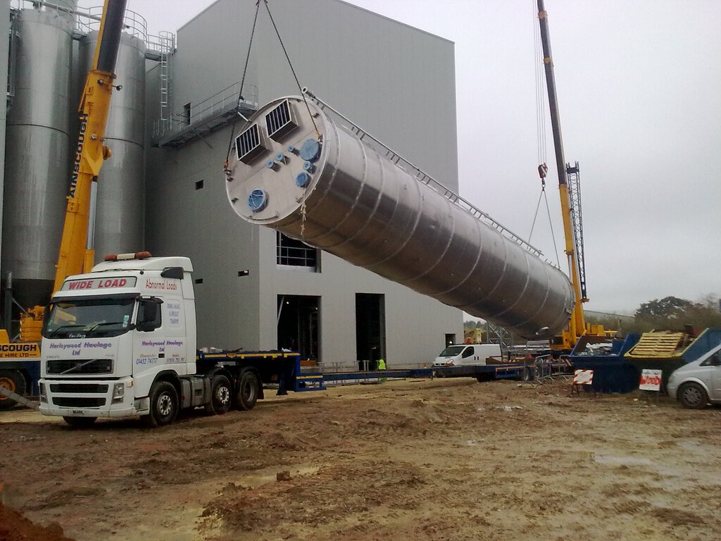

full veiw, whilst unloading
If you load the silo the other way around, with the skirt facing forwards, its like driving with a wind sock behind you, and the fuel consumption gets even worse, i have had 3 mpg before…

Sounds plausible, that if you go quicker, then the engine’s running for less time, therefore it’s more economical, except, as explained above, to travel twice as fast you need 4 times as much fuel to overcome wind resistance. Comparing 56 to 50, 56x56=3136, 50x50=2500, 3136/2500= approx. 1.25, therefore the faster speed is c. 25% more expensive on fuel (all other things being equal). 1 more hour is c. 11% more time 9 hours to 10 hours, so to “waste” 11% time you “save” at most 25% of the ever more expensive juice. Assuming you cover 500 miles in a day (!), then the faster speed might use 50 gallons say (optimistic I know), the slower would then use 40 gallons. 10 gallons = £60? So unless you are paid more than that per hour (super super tanker driver?) the lower speed (up to a point) is more economical, not taking into account all the other factors. As for the big tube and the big square being transported in the above photos, there’s nothing to be done in terms of aerodynamics; but driving slower yet still keeping it in top gear should be more economical on fuel. I would be interested to hear the detailed overall savings made by Tescos running at 80kph or whatever it is. I challenge any of our regular readers to prove my figures wrong. Shouldn’t be too difficult.
