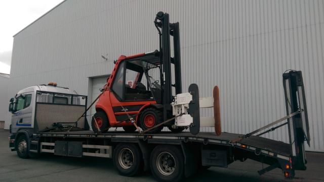

This was some of the gear I moved in my first six months on semi low loaders, got loads of the usual gear but this was some of the more bizarre and some typical gear we carried.
C
This was a pain in the rear to get on mine, bald tyres and damp ramp with nothing on the rear to winch it on with, had to go forward
And in a rush I loaded this, Then measured the mast… 17ft on the bed, all that work and had to take it off :blush:
and yes I did turn the clamp around.

Drift,
Love it dude, some good pics there. Never moved a FLT yet, they just look horrid to load, my hat goes off to all of you boys low’s or rigids who move them. Proper nightmare stuff I imagine!
Yeah been there and done that, had one really recently loaded a long reach and a sliding arm both going to Bristol for auction, first loaded long reach against swan neck/head board (whatever you like to call them) after sliding arm was on the upper deck, obviously, minimum height 17’ 7" :open_mouth:
End product below finished at 15’ 11" after much juggling and checking height 8 times in different places too :blush:
