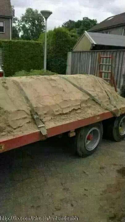

So how do you secure 24 ton of sand
In a hard bodied tipper that is certified to transport 24 tons of sand securely. The body of the tipper is the restraint. If it is in bags on pallets and weighs more than 400kgs each, you use a strap.
so in the event of a roll over what stops spillage :wink: :wink:
You cannot prevent the load departing your means of transport in case of a rollover, not in a tipper, not in a curtainsider, but that is not what is required either.
The requirement is that under normal operation, including hard breaking to avoid a collision or traveling at posted speeds through bends, or braking while cornering at posted speeds a load stays secured.
Nowhere does anyone say that your load must remain in the trailer/tipper if you stupidly roll your wagon down a ravine in Wales.

nick2008:
OVLOV JAY:
nick2008:
Very Good
nick2008:
:lol: :laughing: :laughing: :laughing:
OVLOV JAY:
nick2008:
Very Good
make a sandcastle :smiley: :smiley:
