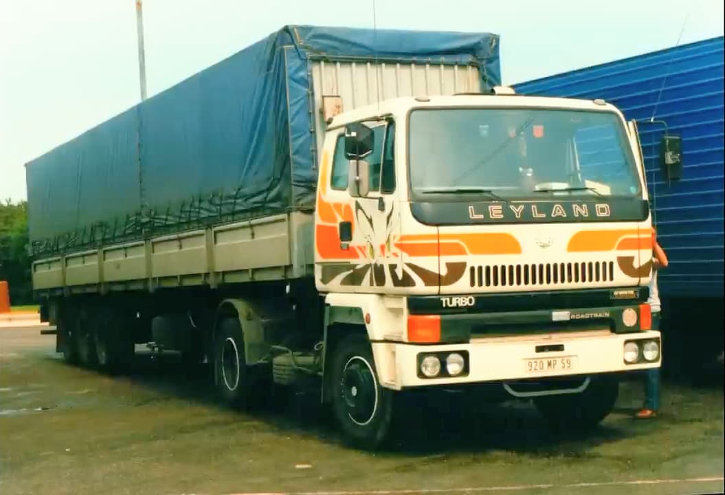

Here’s a question to those of you who know your way round the French online sites. Does anyone know what driveline this French Leyland Roadtrain Interstate had / has? Later French Roadtrains could come with a Rolls 350 with Fuller RTX 11609 (9-sp) ‘box. It’s the only LHD one I’ve ever seen with an Interstate cab. It looks as if it might be in preservation. Again, does anyone know owt about it?
Robert,
Not sure at all, but somewhere in the back of my mind think it might be something to do with TAF from Lille/ st Omer way ? They used to have GMC and several other odd sorts of motors. Red and white frigos, also think the 59 plate is from that neck of the woods ?
Yes! Of course! I do remember them and they ran GMC Astros IIRC - just the sort of outfit to mess with Leyland Interstate units. Cheers! I’ll investigate further :grinning_face: :+1:
EDIT to say I’ve explored some good sites covering Transports Artois Frigorique, including this one:
but no sign of any Leylands.
