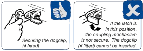

Dunno then?:
I voted no cos I never do. Cant really see the need,the L shaped lever is spring loaded and indeed would fall under gravity into position. Having said that I always look to make sure it has. How far do we need go with locking devices? The early style 5th wheel only had 1 safety feature ie. the dog clip. No one suggested it should have another clip to prevent that one from coming adrift. Take it to its extreme and you can imagine a long line of ever smaller clips all preventing the next one from dislodging :open_mouth: . And all of them smothered in thick black turntable grease :angry: :wink:

Jost 5th wheels… the ones with the L shaped safety catch that drops down as the handle goes in.
They have a dog clip aswell (usually on a little chain) [sometimes its missing]the necessity of which is questionable. Do you always use it?
Its a long way under, means stretching over the wheel arches (nasty in winter)
& is tight up to the greasy trailer swivel plate.
I usually do.
This question ONLY applies to this type of 5th wheel.
you don’t need the dog clip as it has a automatic Clip,but when dog clip is fixed is it a legal requirement to fit them!
Precisely, Fred … and all new motors have them so they must be there for a reason
I really don’t see what the problem is here. If it has a clip, fit it. It takes two seconds. And I have short unreliable arms, so it obviously isn’t that hard.
Since I don’t make a habit of wiping my wheelarches against the underside of trailers when I pick them up, I don’t find I get dirty doing it, either. A bit wet occaisonally, but hell, what’s a bit of water? Just wear a seperate jumper for mucky outside stuff.
And if you wear gloves and angle the clip right, you don’t get any grease that way either - and again, that’s speaking as someone with a quite major intention tremor!!! :unamused:

Yes I absolutely always put my clip on, the only exception would probably be if I was shunting a trailer a short distance but that doesn’t really happen.
I was under the impression that if a chain/clip is fitted, that it must be used?
Every morning I always make a point in checking it too, I wouldn’t put it passed someone these days to pull the clip and handle out so I or whoever was to drive off without checking and dropping the trailer.

I have to agree with most people - if you check that the handle is locked by giving it a push/pull thenit takes about 5 seconds more to put the clip on.

Because the “L” shaped clip is spring loaded,it seens to be a bit belt and braces to have a dog clip.But,I agree with you all,if it’s there,FIT IT!
I’ve voted “always”, in reality I don’t very often use that particular type of coupling but always use the dog clip if there’s one to use regardless of the type of fifth wheel coupling.
:laughing: if there are fife holes can you fitt fife Clips and you must use all of Them,if with or without reason. :exclamation:
Fifthwheelbuilder build Fifthwheel that they are Safe in Use,and fitting aditional Safetyclips means not the it is without unsafe or Ilegal,as it is already fitted with an Safety-L :exclamation:
If in doupt just fitt some extra clips.
anywhy,if you know how a Fifthwheel is build and how it works will you find out that the Clip is over,becouse its holds its looked by the Spring on the Handle underneed the Plate,and if you loose “one” Part on the Closing or loking Mechanismus underneed than helps you no Clip anymore :bulb:

When You hock up will you hear twice the fifthwheel.First when it closed,and the second Time when it’s locked.At that Time must be the Handle in the Gap,provided,or anything is wrong.To fit no a Clip on a wrongworking Fifthwheel makes you not a safe Driver, You agree?
