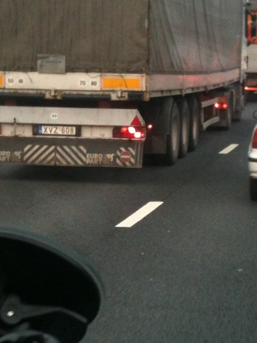

i saw this today whilst parked on the m25, is this normal, the trailer looks broken or overloaded■■?
only a tilt they bend like anything, totally normal :unamused: :unamused: :unamused: :unamused:
oh ok, was just curious just thought it looked overloaded. :slight_smile:

Some of the euro trailers really are crap, you’re right in that it doesn’t look right but I suppose as long as it gets him there, I saw one yesterday, don’t think it was foreign, looked like it was about to snap over one of the back axles. Some of these extender trailers for the long steel loads are designed to bow in the middle though.

Also if you look at that picture, the unit is on those poxy low profile wheels so thats why the front end looks like its dropping a lot. If you’re carrying something like a slab or big coil of steel in the middle, the trailer will bend like that.
+1, some people adjust the air suspension so the combination runs a bit more level. Some people donkey about with the trailer scuffing the catwalk it’s a personal choice…
I agree with the other posts about how flimsy european trailers are. I loaded a 12t gearbox on a Krone Euroliner once and the thing was bending like a banana.
