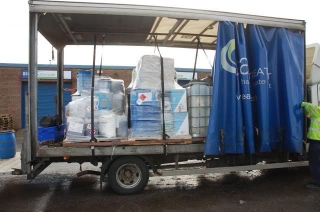

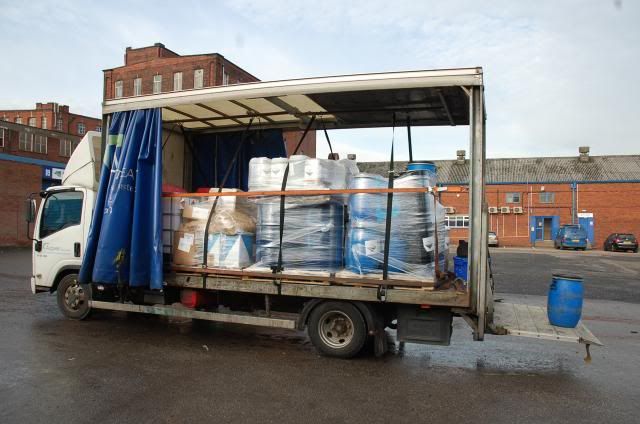

this is how we have had to strap our loads since getting a verbal warning off vosa last June bottom (orange) strap is crossed over to internal hook on opposite side and ratcheted down tight to stop rearward movement with the roof straps everything should stay in place so should keep Vosa happy !

That little lot looks a bit heavy for a puddle-jumper with a tail lift. I suppose those roof straps LOOK nice, but are they actually doing very much?

All vosa would do in this case is to offer advice on better strapping if those pallets are over 400 kg as at least he’s made the effort and it looks like he’s tried.

weight shown on internal gauge 7420 with me on board on scales at destination 7430 so within legal specs drives ok just means have to take things steady pulls alright up the hills when loaded like this actualy more stable when heavy . re the straps told to use the roof straps when we got the warning by vosa and also fasten the load to the pallet hence the ott shrink wrapping not that it will make much difference with some items but shows an attempt to secure was made
They reckon you’re not meant to use internal straps to support a load full stop. If you’ve made the effort with internals and its the first time you’ve been pulled up about it then you’ll be sent on your way with a warning to use ratchets.
Get pulled again with internals and its fine time. That 7.5 tonner above has got fine written all over it.
As for load bearing curtains: doesn’t the load have to be within 3’’ of the side on the whole entire length? Might be wrong.

funny that as VOSA (M60 jn 20 ) told us to use the internals and we would be fine the orange strap that runs from the front hook to the opposite rear hook and is ratcheted tight prevents the pallet moving the internal stops the load shifting off the pallet as does the shrink wrap . so far we havent had any problems with loads shifting when strapped like this will see what happens when and if we get a pull
Probably depends which ranking member of the hierarchy stops you but i was under the impression internals are now seen as good for nothing.

At least the roof won’t blow off!
