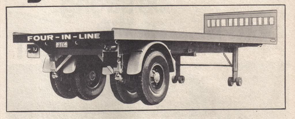

From the Horses mouth Bewick this is what BTC say about the Four-in-line they manufactured, Four-in-line running gear makes up a large proportion of the output of the BTC range. This running gear can be found operating throughout the world and employs four spring suspension with the springs situated above and below each oscillating axle. The axles are carried on trunnion brackets and the centres of the axle stubs and the trunnion are on the same level, thus allowing universal movement without tyre scrub (hope your following this). Many types of trailers are made in the range from straight frames, through to step and drop-types to machinery carriers, pole carriers, skeletals, coil carriers, vans, tippers and bus body trailers (mainly for airport use to carry up to 100 people, these did not comply to highway operations regulations in the UK). Of course they also made other configurations and bogies and dolly types for indivisible loads as well as bodies and fifth wheels, one of the few trailer makers to do so. Hope this adds a bit of knowledge and interest.

From the Horses mouth Bewick this is what BTC say about the Four-in-line they manufactured, Four-in-line running gear makes up a large proportion of the output of the BTC range. This running gear can be found operating throughout the world and employs four spring suspension with the springs situated above and below each oscillating axle. The axles are carried on trunnion brackets and the centres of the axle stubs and the trunnion are on the same level, thus allowing universal movement without tyre scrub (hope your following this). Many types of trailers are made in the range from straight frames, through to step and drop-types to machinery carriers, pole carriers, skeletals, coil carriers, vans, tippers and bus body trailers (mainly for airport use to carry up to 100 people, these did not comply to highway operations regulations in the UK). Of course they also made other configurations and bogies and dolly types for indivisible loads as well as bodies and fifth wheels, one of the few trailer makers to do so. Hope this adds a bit of knowledge and interest.Just for fun who remembers these British Trailer makers, there were quite a few in the Sixties; Arrow (Blyth, N/land), Boden (Oldham), Brockhouse (W Brom), BTC (Trafford Pk), Carrimore (Stanley, Co Durham), Carter (Car transporters, Tamworth), Charrold (Huntingdon), Crane Fruehauf, of course (Norfolk), Dayson (Stourport), Dixon-Bate (Drawbars mainly, Chester), Duramin (Lydney, Glos), Dyson (Liverpool), Fox (Liverpool, these also made a unique type that could convert from Scammell coupling to Fifth Wheel or visa-versa by the driver), Fromant (Bognor Regis), Hands (Letchworth), Halson (Car and recovery types, Newhaven), Highway (Southampton), Hoynor (Essex), HWP (Doncaster), King (Market Harborough), M&G (Lye, Worcestershire), Merriworth (Dartford), Murfitt (Wisbech), Northern (Bishopbriggs), Peak (Stockport), Pitt (Winchester), Primrose (Burnley), Scammell (Watford), Seaway ( a new kid on the block in the late Sixties, Greenock), Taskers (Andover), Thompson Trailmobile (Gloucester), Walker (Stockton), Weeks (Hessle), Welford (Tippers mostly, Tipton), York (not from York but Corby!), there were one or two others but they were mainly special types the above built generally all the range, so if you didn’t pull most of these then your not a proper driver! Only kidding, now how many are left! Franky.

The maker was Dayson, easily confused with Dyson so not a good choice of name but both offered standard range trailers. Overland doesn’t appear in the list from 1968 I have, were they actually British made and around then. As you see I put a pic up of the BTC 4-in-line and it gives a better view of the suspension. Funnily enough I was at a Van Hee get together a couple of weeks ago and the Four-in-line came up in the conversation, I know my Dad and his mates during the 60’s/70’s were’nt too keen on them as they had a tendency to want to roll on corners and the ex Van Hee lads confirmed this during the conversation but like all strange configurations in transport they were developed to over come some of the archaic regulations at the time to allow max payload, weights, length limits etc and I suppose served a purpose at the time, how diverse it was to be a driver or fitter in those days. Cheers Franky.
