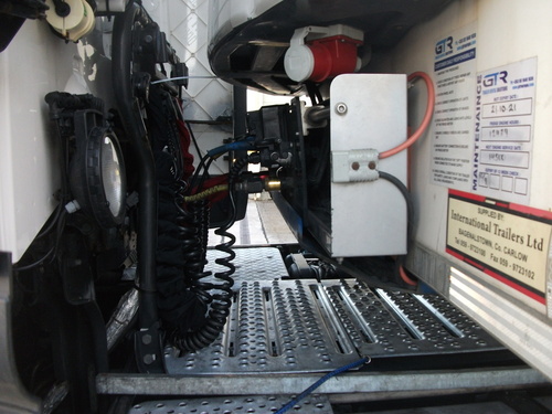

This one on a hire trailer is about as much use as ■■■■ on a fish.
