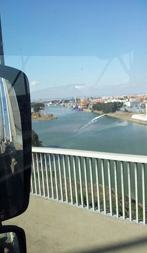

Perhaps you have never been to Spain in a truck or looked at a map.
Seville is not a port , so how do we get to the port without the necessary paperwork …Sodding Helicopter ?
Being pedantic on August 21st 2012 this ship visited the port of Seville.
en.wikipedia.org/wiki/Azamara_Journey
I see ships :wink:
[/quote]
Seville not a port ■■? in that case when I was skipper of the Klazina C workin for Carisbrooke Shipping from the Isle of Wight they obviously sent me to the wrong place, btw, Christopher Columbus remains lie within the Cathedral there near to an Irish pub that does great imported Guiness, hth.
edit … also some decent cat houses within reasonable taxi ride, was in one (purely as a spectator) when it got raided by the localGuardia Civil and they carted of all the girls … demanded my money back !! Obviously never been there so apologies
Oh yea, and also did a spell or six with Richard Long so more than likely did the road route to most of Spain as well.
Oh and I’ve also left my brain cells somewhere and delivered to supermarkets !!
Haha I’m beginning to sound like the Tobester, Famous Grouse works wonders :slight_smile:
