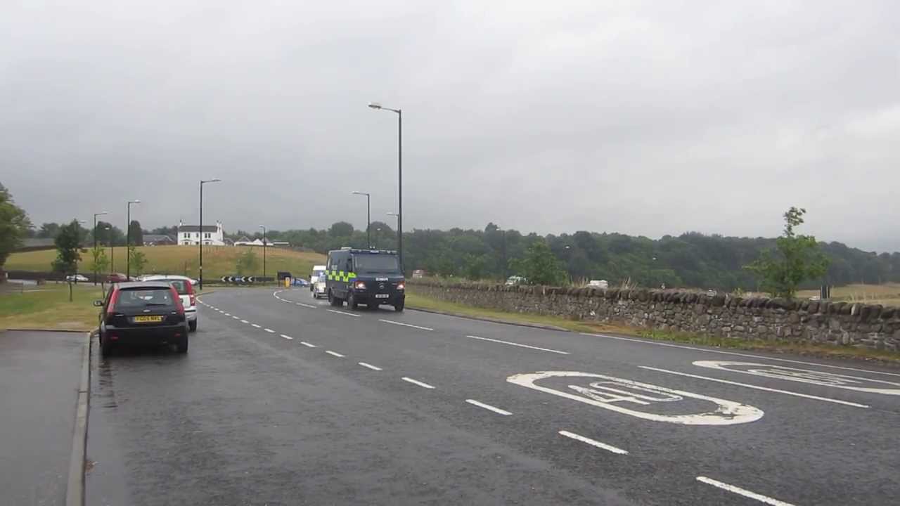

If anyone has been carrying these - I’m gonna nominate them for one of the “Trucking God” awards on the other thread… :open_mouth: :wink:
Winseer:
https://www.youtube.com/watch?v=E3l_ILUVv4U
Could do with a bit more back up though… :grimacing:
