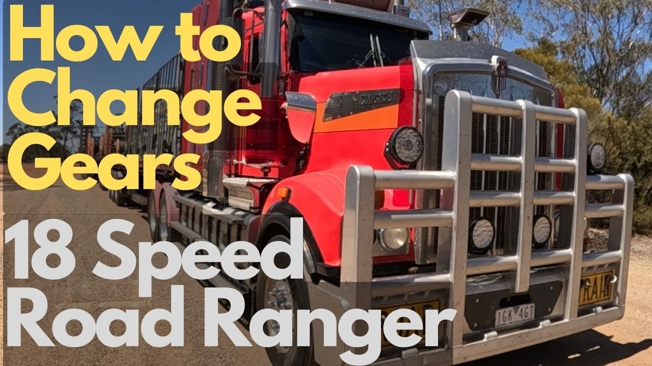

I’m not qualified to comment on this video but there might be someone here who can:
I learned from one commenter that the range-change is a synchromesh and thus needs the clutch to work properly.
I drove quite a few 13 speed Fullers which were 8 over 4 and the range change only operated in neutral which is pretty standard. The splitter which only worked in top box didn’t need the clutch just ease off the accelerator and back on again. Totally irrelevant to this 18 speed video but i’m guessing the same basics with an extra range for the 18 speed?
The 18 is in reality a 13 that has been plumbed so that both ranges can be split.
Technically, because of the syncroniser, the clutch should be used.
I have it on authority of a fellow who rebuilds them for a living, that the rest of the box will be totally knackered, well before the syncro gives up. The syncro is a cheap part that is replaced as a matter of course, whenever any work is done to the box. Ergo, there is no reason for the clutch to be used in practice.
