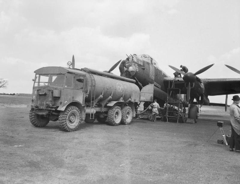

RAF Refueller
S for Sugar was obviously a lucky aircraft look at how many raids she’s been on
