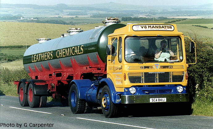

Found this on the AEC societys webb site.Photo taken by G Carpenter.
Everyone who as commented on them seem to be saying the same thing ,they flew ,does this mean they were fast or that they could pull as well? i always thought Mercedes were fast but fairly gutless on the hills unless they had the big engine in them

Ramone they were very fast for the time and pulled really well and could be seen in the THIRD lane of the M1 steaming past other vehicles on Loughborough bank. I would not say they were as fast as a 290 F88 but they were few years later

one of very few restored v8 mandators
i heard it was down to engine cooling ie not a big enough rad that caused the problems they shouldve tryed the v8 in a marathon now that wouldve been some motor
The restored AEC in the pic above is one of two, the other being in Leathers colours the same as the trailer, I remember them from an article in Classic Commercial and the owner of these seemed to love them. The yellow one is done in AEC’s factory colours but the demo I remember was all white, can’t remember any writing though but sure it had AEC V8 on the headboard.
They certainly could pull and go, around 250 HP was a lot in those days and could handle the 32 Ton Gross easily, I’m sure if the engine didn’t give the problems it did then it would have been remembered for more favourable reasons. The higher datum cab was an attempt to solve the overheating as it allowed a larger rad to be fitted and I believe a header tank helped too but I think its fate was sealed by then. Anyone who drove a V8 regularly would be getting on now, into their 70’s or 80’s if they were about 30 to 40 then as they didn’t tend to give motors like these to guys in their 20’s so not so sure you would get too many first hand accounts Ramone. Good subject though always had a soft spot for the AEC, good or bad. Franky.

this v8,is owned by a good friend of mine.mark wiltshire,i think that,as neil james (white v8) above,they both have been converted to fuller box’s.
