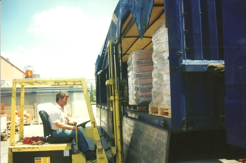

These bags were going nowhere, 24 pallets in a 24 pallet trailer, 24 tonnes.
Sideboards up, timbers in and shrink wrapped bags.
You can see from the headboard and the roof struts, it was a sturdy old trailer.
He tipped them all from this side, too, bless him. :slight_smile:

I think maybe side boards may be the way forward,(maybe backward) with proper eyes to strap down to.
This lot didn’t move a millimetre all the way from Padova to Oxford.
There’s barely 4 tonnes on there,any straps would have to have been so slack as to be of little use,
they are shop display fridge units.
I don’t suppose either would pass the VOSA test these days.

Fridge Units from Arneg SPA :stuck_out_tongue:
I guess so, though I would never have remembered the name. :open_mouth:
How did you??
They worked into their lunch break to get them packed and loaded,
bless 'em.
As we left, so did they.
Regards,
Nick

ncooper:
Wheel Nut:
How did you??
bless 'em.
Regards,
Nick
iirc, they gave you a carton of wine with your free lunch while they loaded us :stuck_out_tongue:
