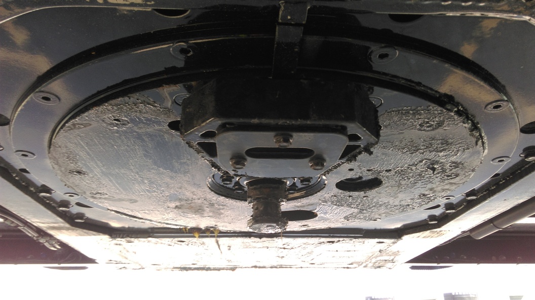

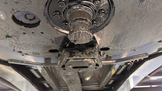

IMAG0818.jpgFor those who are not sure what the wedge looks like…

01For those who are not sure what the wedge looks like…
Hope you had your hard hat on B B :wink: we called them cheese wedges .
