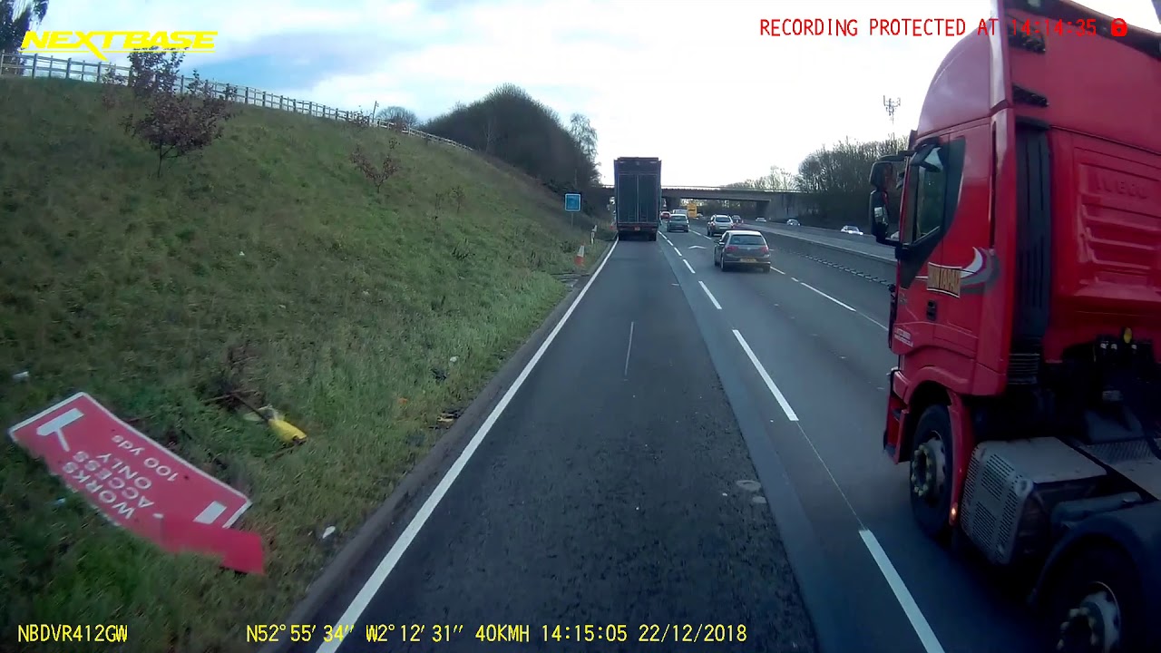

Hasn’t dropped the suspension to ride height no wonder he’s kissing all the bridges
Brilliant idea imo, shave a little off on each bridge and eventually you’ll fit under anything.

The thick ■■■■ is driving with his trailer suspension air bags fully inflated. Clear as day in the 1:43 clip. Trailer is about 17 ft high.

Drivers responsibilty…
To ensure his truck and trailer is fit to travel safely.
I used to tip a DD at Asda Bedford on nights. They’d raise the suspension right up to tip it but never told you they’d done it. As a matter of course, I walk around and check things and to be honest, I spotted it as I walked up to it what they’d done. A few months later, I’ve got the gaffer on the line telling me that a newbie had clouted a bridge on the M1 northbound with a DD.
Doesn’t take much to walk around the whole thing and check stuff is where it should be.

Checking the ride height and height clearance is part of your walk round vehicle check. Nothing needs to be changed except the thick ■■■■■ have their licences cancelled.

I pull DD’s quite often And in ten years i twice had a fault with the suspension and it had raised to max height on the journey back (both times trailer was empty) only way it would reset was to lower it totally then let the air build up. Pressing the reset button in the back of the trailer failed to work. Both times i knew i had a problem was a booming sound when you go under a motorway bridge. So the driver may not be a moron he may just got a fault with the trailer.
Would it not be better to equip a trailer to auto adjust? There’s huge inconsistencies in trailers but standardising some things would help. Our newer trailers the ride height adjuster pops out over a certain speed so it’ll default to ride height when running.
I dont know if its a thing across the board that has to be installed on new trailers, but if it was it would stop this from happening.
